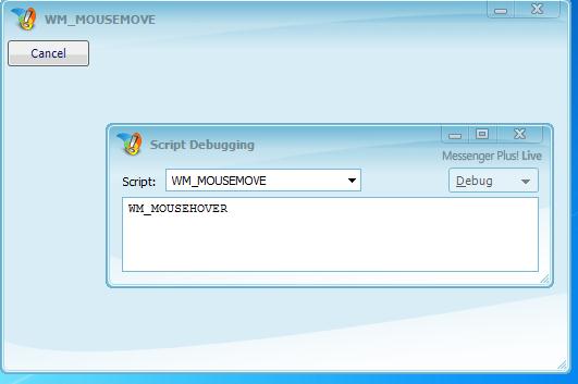

Good news... bad news...
Good news is I managed to get it to work with the Plus! Window. Unfortunately I can't see how it will work with controls.

[Image: attachment.php?pid=992973]
