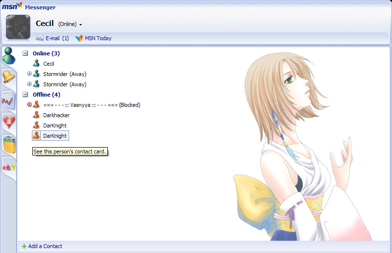

RE: This is how to change MSN7 background.
I also get the black fading to white, but only happens once. Nothing major.
Here's an attached shot of what I got, also.
This is way better than lvback.gif. Now you can have a high quality image. :)
Edit: Reason for so few contacts is because it's my testing account. :P
