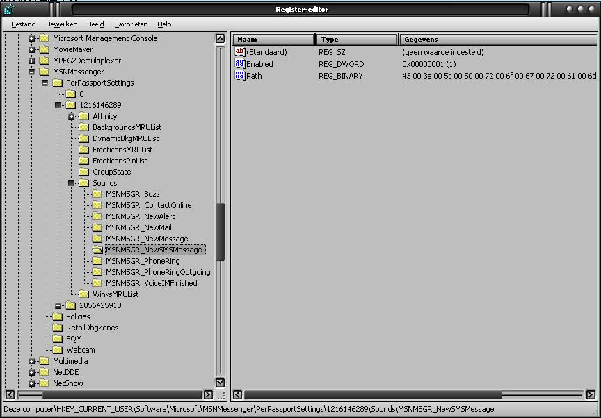

you can make it work by creating HKEY_CURRENT_USER\Software\Microsoft\MSNMessenger\PerPassportSettings\<your messenger ID>\Sounds\MSNMSGR_NewSMSMessage\Enabled in your registry, with <your messenger ID> being a 10 digits code.
If you're the only one using messenger on your PC, there should be only one ID in there. If there are more, just add the value to all of them ;)
This is what mine looks like now:
.jpg File Attachment: messengerkey.JPG (78.2 KB)
This file has been downloaded 348 time(s).

Yeah, that's my fault. I assumed registry keys were a standard for every WLM user, but it appears that it's location dependant. Now, this may mean that there are some keys that I don't have, which Mute will not mute, but I doubt it.
Adding that key won't be necessary. I've fixed the script to ignore keys that you don't have. Check the first post for a newer version.

Well, this is the message that I have received in the Debug Windows:
Función llamada: OnGetScriptMenu
Función llamada: OnEvent_MenuClicked
Error: Raíz no válida en la clave del registro "HKEY_CURRENT_USER\Software\Microsoft\MSNMessenger\PerPassportSettings\2864120175\Sounds\MSNMSGR_NewSMSMessage\Enabled"..
       Línea: 29. Código: -2147024894.
La función OnEvent_MenuClicked devolvió un error. Código: -2147352567
Sorry, the text is in spanish because I have the software in my language. If you need help for translate it, contact with me.
Please, help me! :-D Thanks!
Hi!
I'm happy, because I have solved the problem. I explain to you what I have done.
The entry in the registry of Windows
"HKEY_CURRENT_USER\Software\Microsoft\MSNMessenger\PerPassportSettings\2864120175\Sounds\MSNMSGR_NewSMSMessage"
not appears in my computer. I think this is because I have Windows Live Messenger in Spanish and then, some options are diferent. So, I created a new entry in the Registry with the same parameters that the others that I have find in "Sounds".
Now, Mute 1.2 funtions perfectly.
Thanks!!
