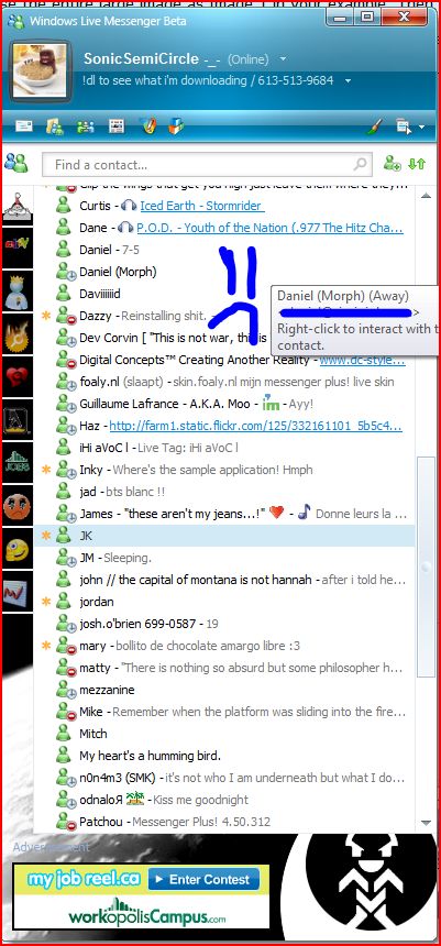

Together it makes this
[Image: captureyz2.jpg]
Now everything looks good.
The 2 pictures look like they are 1 giant image going across the Contact List.
But what goes wrong is when I use the MP!L Option inside my script to remove the Search Bar.
[Image: captureaj2.jpg]
The consistency breaks because there is more space for the contact list to expand.
I'd like to know if there is a way I can make it go all across so it's 1 giant image and not 2 images.
