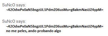

Well, my problem is this :
I got my own msg on the ChatWndSendMessage event. I modify it and made a return so it appear on my convo. Ok, i made a return and made a SendMesaage to send it to the other person but i see that modified msg. With some modifications i see both msgs
The point is.. can i only see my normall msg and send the encoded one ?
Im thinking and maybe that (see every msg) is a security issue
.jpg File Attachment: plus2.jpg (10.1 KB)
This file has been downloaded 178 time(s).

[align=center]the problem is that you have a send msg inside the chatwndsendmsg event. When you send the text msg it will be encrypted and sent again encrypted..then you have a return after that so it will send also that msg. Instead of using the chatwnd.sendmsg function just do return secureEncrypt(claves(1),msg)...

If i try that, i send the  encrypted text and i see the encrypted text
As i say, i don't want to see the encrypted text, just the normal one
Thats why i send the text "twice" (normal and encrypted)

What exactly do you mean? That only sends one message...
He wants to send the encrypted message to his contact, while it shows the unencrypted message in his own client. You cannot do this (easily) with MP!L.
