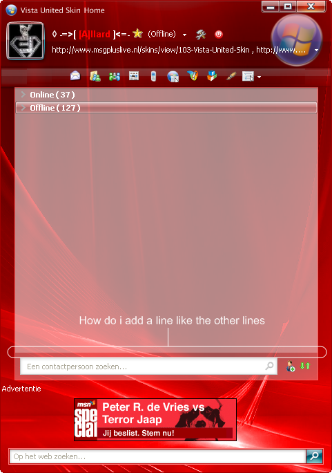

Can anyone tell me how i add a border to the contact search bar. I have put the bar from the top to the bottom and now i want to have a line in it to separable the contactlist from the searchbar.
.png File Attachment: AddBorder.png (204.91 KB)
This file has been downloaded 154 time(s).

Have you tried 1001 def?, look for:
<Element LayoutPos=Top Layout=BorderLayout() BorderThickness=rect(0,0,0,1) Padding=Rect(0,0,2,0) ID=Atom(ai550)>
and modify that borderthickness to what you want, something like:
BorderThickness=rect(0,1,0,0)
If you want to change the border color then go to 1001 style and find:
Element[ID=Atom(ai550)]
BorderColor:rcclr(20023); /* Colorized. I=234 */
just put the color you want over there :P
hope that helps dude :D

Hey it works :D Thank you for your help;)
