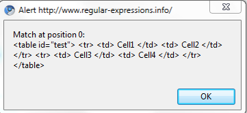

Yes, it does work. Maybe there is some strange character in the html?
[Image: attachment.php?pid=986406]
EDIT: Try adding the m modifier to make it run over multiple lines... My test was on a single line basis
.png File Attachment: Capture.png (11.67 KB)
This file has been downloaded 1545 time(s).
This post was edited on 01-29-2010 at 10:14 PM by Spunky.

Line breaks are casuing it to break and I can't get the m modifier to work so we can add an extra replace.
Javascript code:
html = html.replace(/\n/gi, "").replace(/\<table.+?table\>/gi, "");
If you wanted to, you could replace the \n with a unique string so it can be put back together again...
Javascript code:
html = html.replace(/\n/gi, "this-used-to-be-a-line-break").replace(/\<table.+?table\>/gi, "");
html = html.replace(/this-used-to-be-a-line-break/gi, "\n");
