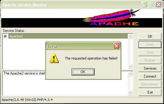

Well I've never set up PHP in Apache...or anywhere for that fact before, so I used a tut. to install it, but it doesn't seem to have work, even though it shows up in the console as being enabled, the site still tries to get you to download the .php file instead of executing it :S
[Image: attachment.php?pid=217094]

Minjul, thx for the help, but first off I had already done the php.ini file thing bcz of the tut., but I replaced the cgi.force thing, and copied php4ts.dll into System32, now Apache woon't start X_X
On using the "Test Configuration" Function on Apache, I get no errors :S
[Image: attachment.php?pid=217102]

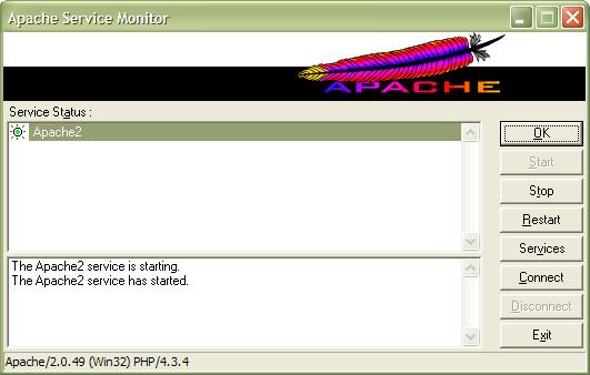

I still get the error...this is really strange X_X
Edit:
I know what's wrong, I started up KaZaA...it's causing me to have no available socket for the server to start in...lol...I will test again and see if it worked! :P
Edit, yet again:
No...didn't work :'( I don't get the error anymore, but it still tries to download the PHP file X_X
