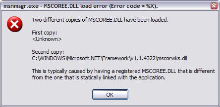

jsut wanted to try the reload on c# plugins...
and i hate the language already...
i was trying to load the default .NET plugin patchou made and after finding the regasm in a god forgoten directory, i finally registr teh plugin
and here is my reward !!!
.jpg File Attachment: .net error.JPG (19.14 KB)
This file has been downloaded 271 time(s).
