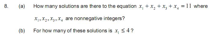

;o another math question for you smart math people :P
I've got a diophantine equation
[Image: attachment.php?pid=909365]
I've solved part A by doing
14x13x12/ 3! = 364 (which i think it correct :P)
but I'm stuck with part B, i have notes on how to do them if they are >= something but :-/ I've never encountered a <= one so I'm unsure of how to solve it.
so can someone please help the dt :P
.jpg File Attachment: math.JPG (13.25 KB)
This file has been downloaded 470 time(s).

I can be completely wrong... but why isn't that 5/12 of the total amount?

Originally posted by -dt-
i have notes on how to do them if they are >= something but (Smilie) I've never encountered a <= one so I'm unsure of how to solve it.
It seems to me if you know how to solve it for x1 >= 5 (which you are implying you do), then you could subtract the number of those solutions from the total number of solutions and get the answer you want....
05-22-2008 05:40 PM
oh :D thanks I never thought of that
05-22-2008 11:44 PM
Jhrono
Posts: 1787
RE: Math Question: (Diophantine equation)
Will that work? Remember that the procedure you are aware of also includes the = solutions so, those will be common. By Adeptus method, you'll obtain the < solutions. Or am I looking at this in a wrong way?
if i change it to >= 4 and then subtract it, i should get the same as <= 4, shouldnt i?
edit:
OH i see what you're saying... hm... maybe if i just do > 4 *looks for his notes*
oh wait i would have to subtract > 6 to get the < 4 stuff right? :P or am i just confusing myself more....
edit:
oh *reads Adeptus's post below* *fixes what hes done*
The reason why my "method" was fine is because in a diophantine equation, all variables are whole integers.  Thus, if you remove everything >= 5, what remains will be <= 4 -- because there obviously are no whole integers between 4 and 5.
if you know how to do it when it's >=, then you can calulate it when it's >= 5 and substract it to the total, so you will get for how many solutions it is < 5 or in other words <=4 :P
As for the first problem, i dont remember how to solve such kinda problems and i cant figure it out, so i cant verify if your answer is ok :P
i see you solved 14!/(14-3)!*3!, but why? I'd like to know :chrongue:
Eh, I thought the question was <= 5, not 4 :p Sorry
