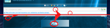

I am using the original definitions now. Can someone hax them in such way, that the things marked with red circles, arrows, in the attachment will be removed?
I don't want to sound demanding in any way, it's just that.. well. I just don't understand how to do it D:

I'll be able to do it for you but will not be allowed to supply the definitions to you in public, please email me your 923 and 1001 definitions thank you.
