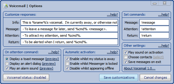

Beta version has been released!  Click here to try it out, and let me know any issues you come across.  In particular, please try the nudge shake option, both with and without the broken switch on, and tell me which works and with what version of WLM you are using.
I've been working on a little answer machine-type script that can take messages, grab your attention and tell other contacts when you return.  You just turn Voicemail on, then it takes over conversations as needed.  You can make it contact-specific if you like, as well as letting it automatically turn itself on and off automatically (e.g. when set to away/idle, locking messenger and so on).
[Image: attachment.php?pid=1013242]
Suggestions welcome.  It's nearly ready to go, but I can still add stuff in if you have any other ideas.  :)

looks cool (y)
The only things I see which might be nice to have are:
Maybe change the radio buttons into checkboxes for the "On attention command" so that the user can choose to play only a sound but not display a toast nor alert dialog. Or that he can choose both a toast (which will dissapear by nature) and a dialog ( which is permanent by nature).
Also, a nice and original* addition to the "On attention command" to choose from would be a simulated nudge (move/shake the chat window quickly, while playing the nudge sound.... well, you get the idea).
Ability to choose among the statusses for "enable whilst status is ..." and "disable whilst status is ..." in the form of a checkbox list of all statusses (maybe even incl. 'on the phone', etc, since those are still very valid).
* AFAIK no script has ever done that.
Will do.  :)
I could play the sound, but how would I shake the window?  I guess maybe moving it a couple of pixels and then setting a timer a few times would do it...  maybe make the taskbar button blink - is that possible with scripting?
I'll see what I can do...

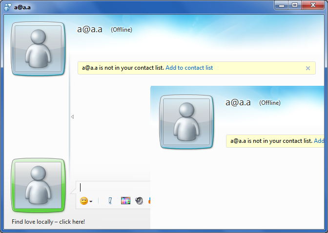

Edit: seems a similar problem occurs (this might be due to the skin I'm using, not sure yet):
Before...
[Image: 1tD1Z.png]
After...
[Image: ZBveJ.png]
The window still works, but only in the bottom bit (where it 'moved' to).  So the "Add to contact list" link that's higher up doesn't do anything, but the lower one still works.
Edit (2): applying the code to a Plus! window seems to work without any problems!
And no, skins don't affect it...

Found something else out: the amount by which it moves depends on where the window is in relation to the top-left corner of the screen.
Example: when the conversation is in the top-left corner, the inner bit only moves a little.  When the window is moved to the centre of the screen, it moves a lot more.
...so by using x and y as 0, it seems to work (but only shakes the inner window, i.e. not the title bar/border, just the content).
Do you think this might be version-dependant?  I'm using WLM 2011 and Plus! 5 on Windows 7 64-bit.
