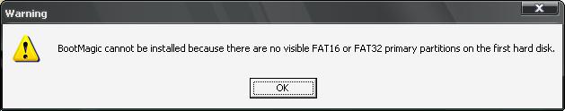

When I try to install it I get this error
[Image: attachment.php?pid=610341]
I know what it means but any reason for this?

Originally posted by SonicSam
C: = 60gb NTFS
D: = 40gb NTFS
It wants FAT16 or FAT32 partitions, not NTFS partitions

Originally posted by http://www.le.ac.uk/cc/dsss/docs/pm4-boot.shtml
BM must be installed on a FAT or a FAT32 partition on the first hard disk drive; BM can't be installed on an NTFS partition.
