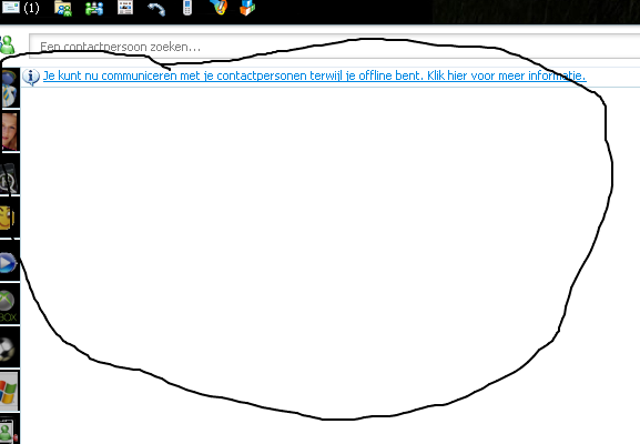

Ok Basilis i now whate to add, but now are my contacts gone:S
What went wrong???
oh and this is my Skin Trace

.png File Attachment: NoContacts.png (36.1 KB)
This file has been downloaded 204 time(s).

The mistake is in line 608, obviously in the 1009 style file
