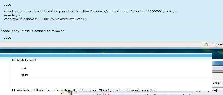

Just wondering, wich one is the correct?
[Image: attachment.php?pid=938708]
code:
testing it with Firefox 3.0.3, by the way
.jpg File Attachment: (48.01 KB)
This file has been downloaded 500 time(s).
This post was edited on 11-25-2008 at 06:56 PM by blessedguy.

ok, I got rid of that evil <font> tag. Let me know if you still see the bug... I haven't installed Firefox 3 yet. :p
11-26-2008 02:58 AM

RE: [code][/code]
code:
testing much??
edit: ok i think its fixed... it had the correct font and that when i first posted it...
This post was edited on 11-26-2008 at 03:11 AM by NanaFreak.
11-26-2008 03:10 AM
