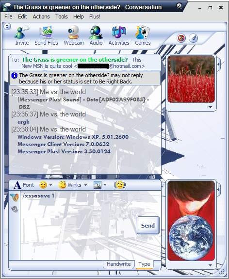

I don't know how or why I can't hear custom sounds... its really odd. No matter what combination of ticks i have in the sounds preferences, they still don't work
see the picture...
I have tried other accounts on my computer and they work fine... its just mine. Maybe its cos of some plus! registy tweaks i did aaaaages ago... but i have no idea what it could be :|
anykhways if anyone could help... I would be grateful, if not, I'll have to do without the sounds :'(

I see that you're using a modded MSN Messenger (or at least did something to it). Run a clean, unpatch, unmodified MSN Messenger, and see if it still occurs...

well... as to answer CookieRevised first... I am using modded messenger with the other accounts... but i tried it anyway... still don't work...

take a sshot like you did before and post it...
