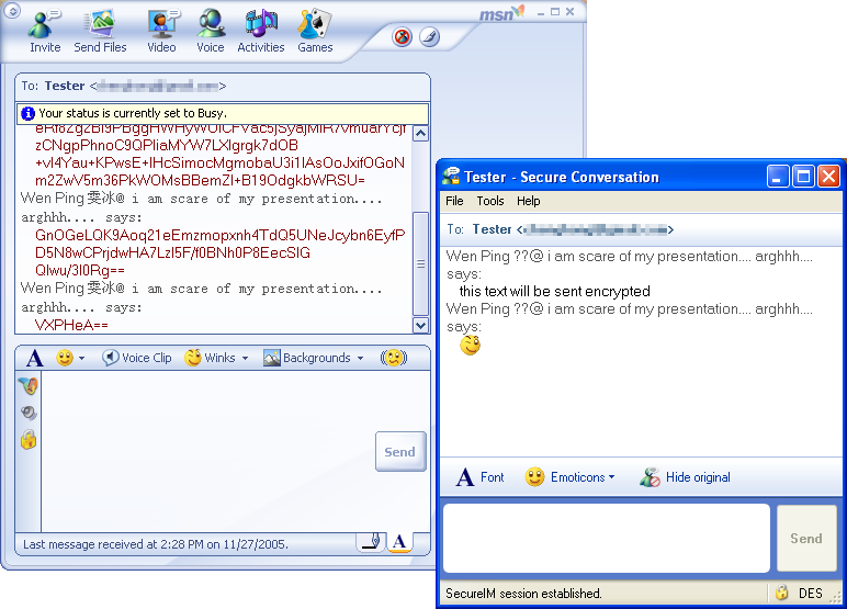

Hey all,
I recently created an encryption plugin that encrypts text before its sent over msn and decrypts it at the other side. Thankfully it all works now, but i want to build on it. Im posting on here in a request for information from all you plugin geniuses.
I have 2 questions:
1.) Is there anyway (maybe using messenger api) to retrieve an email addy on ReceiveNotify? That being the email address belonging to the person who just sent you the text with the notifycode in.
2.) As you can see from the pic below, my decrypted text is currently shown in a seperate window. This is fine for now but what i really want is to dump it on the main chat window. This doesnt have to be in place of the encrypted text already recieved, id be happy if it was simply displaying at the bottom underneath the recieved text, maybe in a red font etc.
[Image: msncrypt.jpg]
I hope someone can help on this or at least point me in the right direction :D.
Thanks
>RooJ

You might be interested to know that I've made an encryption plugin already. It will be released some time later. :) Some major features:
  • Supports 13 types of block cipher
  • Cipher and key management
  • Emoticons support
  • Font support
  • Encrypted file transfer support
[Image: attachment.php?pid=570134]
As for your first question, just use oConversationWnd.Contacts(0).SigninName.

Looks good eSouL,
I didnt put alot of effort into the decrypt client as i really dont want to have to run a seperate exe, although i can see from yours alot can be done with that.
I also have the opportunity for many ciphers but chose to stick to 3des. I was wondering, as many users in your list might be using different ciphers have users got a way of knowing which cipher someone else is using?
Do your ciphers support salt's? At the moment mine randomly generates a salt so no matter how many times you encrypt the same text with the same key you always get a different looking output. Id definitely suggest it if its not implemented already.

Hi RooJ,
There is no separate exe running. Yes it does support salt. I have a protocol for session establishment, therefore two parties communicate with the cipher associated with the session. I guess with VB, its quite hard to write text directly into the conversation window. I'm not even sure if Active Accessibility can do this. Nevertheless, good luck for your project!
