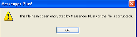

Hey all, i have a problem.
What i have done is backed up all my data, format reinstalled my computer and copied all the data back over, now i cant open my old chat logs.. i have tried to use Messenger Plus! Log Viewer but that brings up an error.
any help would be great thanks...
.gif File Attachment: log-error.gif (5.62 KB)
This file has been downloaded 306 time(s).

RE: Messenger Plus! Encrypted Chat Logs
Maybe you hadn't a completely up-to-date Windows installation when the logs were created. Though it "shouldn't" be an issue...
Also, the file might be really corrupted (can occur if you had errors on your hard disk. This might not be visible at first, but can cause such stuff to happen when copying files.)
A small check you can do is to open the file in notepad. If you don't see all garbled text with the first characters being "MPLE1<<" then it isn't a real encrypted messenger plus! log file indeed.
Otherwise, send the file (together with your password!) to mplus [at] patchou.com so that Patchou can check the file out.

O.P. RE: Messenger Plus! Encrypted Chat Logs
hey, no i dont see that at the start of the log, but keep in mind these logs arent *.ple they are *.xml
If you are using Messenger Plus! 3 Encrypted Chat Logs, the extension should be *.ple.  You could try renaming the extension to *.ple instead of xml
already tried that and an error message comes up that i have posted as an attatchment eariler, thanks anyway mate.... any other ideas?

RE: RE: Messenger Plus! Encrypted Chat Logs
renaming a file doesn't alter its format. Since the file didn't start with those characters at the beginning, it is clear that it isn't an encrypted messenger plus log (.ple file) named wrongly.
XML logs are NOT Messenger Plus! logs. They are logs from MSN Messenger itself. Plus! has got nothing to do with them.
So, of course you're going to get a message that the log isn't a Plus! encrypted log:
1) - The log is not encrypted
2) - It is a MSN Messenger log, not a Messenger Plus! log
To open XLM logs simply open them in Internet Explorer, or open them via MSN Messenger itself (Right click contact > View Message History)
*.XML => MSN Messenger logs (are never encrypted)
- can be viewed with Microsoft Internet Explorer (or any other browser which fully supports XML viewing with XSL style sheets)
- can be edited using any XML editor
- can be edited using any text editor. eg: notepad
- can not be encrypted
*.TXT => Messenger Plus! text logs
- can be viewed and edited with any (unicode supporting) texteditor. eg: notepad
- can be viewed with Messenger Plus! log viewer
- Are not encrypted
*.PLE => Messenger Plus! encrypted logs
- can not be viewed, nor edited, with an editor
- can be viewed with Messenger Plus! log viewer provided you have the correct password to decrypt them
- Are encrypted
