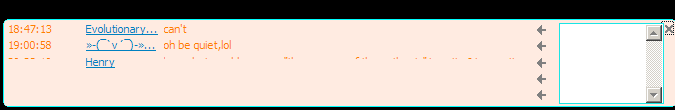

In case you're looking for 'bug submissions'
After I logged back in the wlm preview box looked like (see attached), which i thought was just lag but it didn't go away until i closed and re-opened the box.
Attachment: Cut-off text.bmp (217.9 KB)
This file has been downloaded 160 time(s).
This post was edited on 02-12-2008 at 09:35 AM by blucrill.
