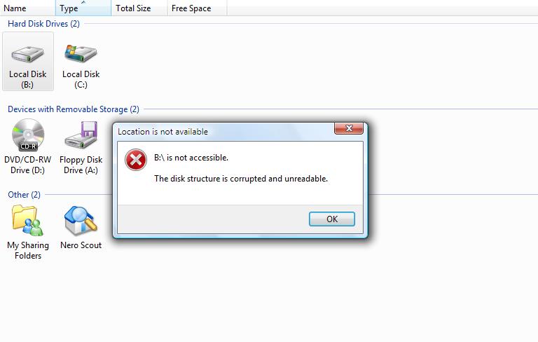

Today i installed Vista Ultimate and everything seems ok til when i run it for the first time, it takes a lot of time to initialize, then i was working prefectly, but when i restarted and tried to acces to my other hd it says that was corrupted
should i have to format it?
can i recover mi files from there?
[Image: attachment.php?pid=731681]
thanks

If it says it's not accessible, then chances are the hard drive is corrupt and completely inaccessible no matter what!
However, it might just be Windows Vista, as it's a lot different to Windows XP (surprisingly), so boot windows xp and try to access the hard-drive using that.

But i already had vista, i only upgraded, and my two hd were working perfectly :s

your B:\ drive has a Vista hard drive icon, yet the letter B is reserved for floppy drives... for me anyway...
I've had no experience whatsoever of using Vista, but if you can, find a way to boot from Vista to XP, then see if you can get in that way.
It's most likely Vista saw the disk structure on that drive and presumed it was corrupt because the structure was ORIGINALLY meant for XP while Vista thought C:\ was the XP (the only time when it was actually right) disk, and the B:\ drive for Vista.

RE: My Hd is corrupted =/
Well, the point you're making about vista and xp doesn't really make much sense, as they are both pieces of software, and vista doesn't need to be compatible with windows xp.
XP and Vista both use the NTFS filesystem, so I'm not sure what you mean here... but, as he said, he only upgraded, so Vista would just have installed over the top of XP. It is possible to dual boot two windows installations (ie. have XP and Vista installed on different partitions), but I dont see the point.

Can vista read FAT32 partitions? if not that might be the case.
Also you can try changeing the drive letter (its under Admin tools>>disk management on XP :P) to something other than B (try E) incase B is still reserved for floppys.

I think it's highly unlikely that even Microsoft would do away with FAT32 supp... actually no it's nearly certain they didn't, most USB flash sticks use FAT/32.
Is B: an actual drive or another partition?
I've never seen a hard drive become corrupted in this way on its own (unlike bad sectors, which can happen for no reason except extensive use), I'd recommend trying out Knoppix or another program which should let you see if the filesystem structure is still intact.
If it isn't... there are data recovery programs out there but they're far from cheap.

FAT32 is gone from Vista just so you know
