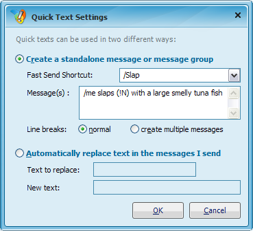

You dont need to make a script to do that, a quicktext can do this. You can do that by using the tag (!N), wich displays your contacts friendlyname (name as set by contact him/herself).
Example of a quicktext using this:
[Image: attachment.php?pid=819291]
With this i can send the old/known /slap command.

10x Sunshine ! :D
can that be addes in script file? cuz I alredy write the script! i just need to put the (!N) in it? would that work?

Yes, (!N) is what you need to display nicknames. If you want emails use (!M).
