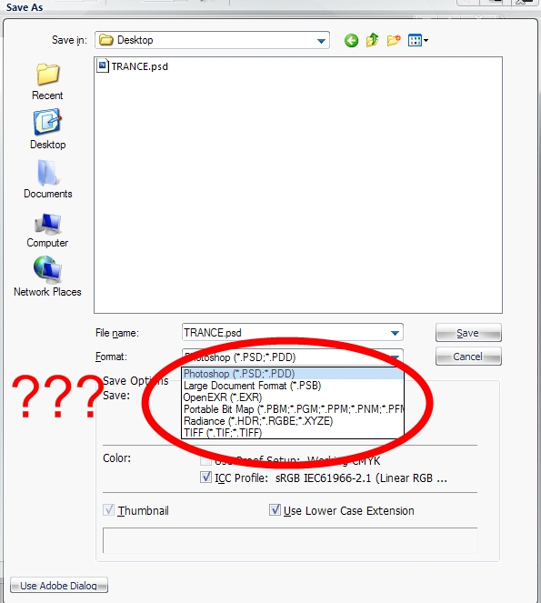

I'm trying to export a project to BMP, JPEG or PNG etc to edit in Paint.NET, but it doesn't have it listed. Is there like some sort of plugin/extension/etc. that I can get to allow me to do this?

File > Save As... ?
You can save as any format

It's mostly likely because you are using a 16 Bit Channel. You need to change it to 8 bit, to do this go Image > Mode and select "8 Bits/Channel" (it won't affect your work don't worry)
Then you should be able to save/export your project in the extension you want =]

It's a 32 bit channel, when I click Save As it just has these:
EDIT: Fixed. (8 bits per channel doesn't hurt the bit depth, right?)
