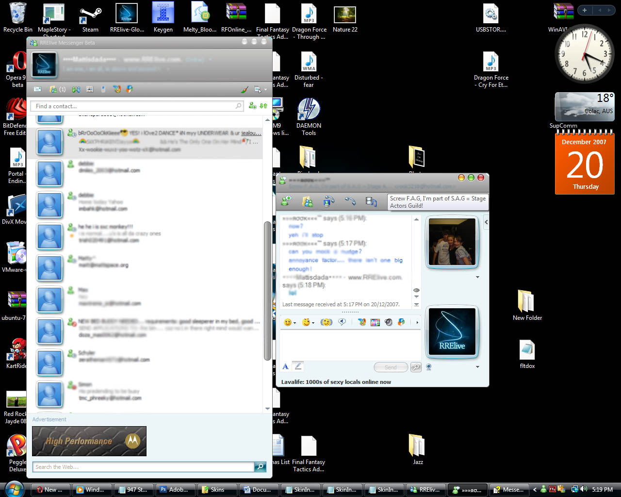

As the tittle says im new to skinning and new to codding.
1. How do you change the text colour of things? Eg the text colour of string "61288".
2. I have the code
code:
<String Id="698">%1 just sent you a
nudge. I strongly recommend nudging them back for revenge!</String>
Im using  %1 as thats the variable they use(in the file msglang_strings which is how you find what each string says and does) to stick in someones name on that string. But aparantly, it doesnt work like that with the skinInfo page, as when someone nudges me it says "%1" instead of the name.
3. Would anyone like to test my skin so far for messenger 8.5? I dont have it so im a little helpless(I have 9).Ansewered
Ive attatched a slightly older version of my skin(picture only) to this attatchment.If anyone is willing to test i will add another attatchment with the skin files :)(Ive changend a few things since the time of that screenshot, i want to get it a little bit more finnalised before i make a newer one(werid i know))
4. I would also like to change the backround colour of conversation windows.
Thank you in advance!

RE: Im new to skinning(And new to codding to)and i need some help.
I'm not totally sure but I think the resources in 8.5 are different so someone would need to extract them for you and send it to you so that you can edit them (as you did with 9.0) and then package them.
If you read the Skinning docs, you can have different resources for different skins. Just use the restrictions for versions before adding resources which are different for 8.5 and 9.0 :)

O.P. RE: Im new to skinning(And new to codding to)and i need some help.
So ive heard. Well, does anyone have 8.5 packages that they can send to me :) So i can at least START to develop for them?
By the way, thanks for the quick reply :)
Here is the skin so far with minor 8.5 changes. It might work.... but heres me doubting it:D.
And if anyone is wanting to use it for 9.0 or just wants to bug test it, feel free to add it.
hey matt
i know that screenshot is early days yet but it looks pretty good so far, i think the custom scrollbars were a nice touch i may try to implement something like that in the next version of my skin as its a pretty cool idea.
i have zipped up the 8.5 resources for you and attached them to this post, however its a 4.52 megabyte file so depending on how fast your internet connection is it might take some time to download, also im not to sure on the size restrictions on this forum for file attachments so it might not attach.
Any WLM 9.0 UIfile will only work under WLM 9.0. It is not backwards compatible nor will it be compatible with say wlm 9.5 or 10 (the next major version)
The same goes for 8.5. 8.5 UIfile code is for 8.5 only.
I've explained the reason why it is like that so many times that i can't be bothered now :P so if you really wanna know just look at my tutorial thread.
http://shoutbox.menthix.net/showthread.php?tid=79906
*Also even if you didn't touch UIFile code and only did image replaces it won't work properly since 9.0 has a lot of image ID changes.
thats very true wills, in my skin i have compatability for 8.5 and 9.0 in total i noticed that 3 images had different id's in 9.0 to what they were in 8.5 but some did stay the same. if he created 2 subfolders in his skins directory 1 for 8.5 and 1 for 9.0 puts the relevant versions uifiles in the corresponding directory and creates a resgroup for each version then it should work on both.

you cant edit the colour of a string just by itself, you need to find it in the UIFile code under the styles section and then use the foreground tag to change its colour for each and every instance (and thats if its there)
secondly, any string you replace is static and can not contain any dynamic content in it.
