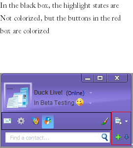

That sorta worked [Image: msn_tongue.gif]
Attachment will explain.
The Code im using to change "20201" and "20202" :

Willz
Posts: 953
RE: [?] Dashboard Highlight Colorization
the code you have seems to be right, However it seems to be that wlm is restricting it from colorizing.
There are some parts of WLM where even if you specify something to colorize, it simply won't. Its not because of a plus bug or anything, its just because WLM is anal and won't let it.
Another example of this is the now playing icon, even if you specify it to colorize, it won't.

deAd
Posts: 1060
Reputation: 28
As Willz said, the toolbar doesn't colorize. You may be able to force it to colorize with the colorize attribute but I don't know if you can make it the messenger color.
