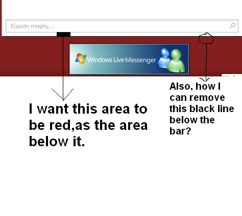

How can the wordwheel be moved below the contact list. I managed to make it go in the lower part of the contact list but there is a problem. when the contact list's background is white, the bar's background gets white also. But I want it to have the color that the sign in window has. So, when I make the contact list transparent, the wheel is for example red, but when it the CL background is white, the bar's background gets white, although the style file says it should be transparent.  So I figured out that the bar and the buttons must go below the contact list. How can this be done?
.png File Attachment: χωρίς τίτλο.PNG (36.98 KB)
This file has been downloaded 129 time(s).
This I can't tell you...but I wanted to ask one thing...how did you move that to the lower part of the buddy list?!?!
See attached screenshot above
