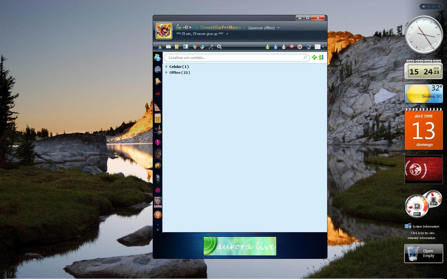

RE: [HELP] How to move the contact search bar from top to bottom?!
huh?
[Image: 2409233382_aaf9da5ab5.jpg]
1001 definition:
code:
    <Element Layout=BorderLayout() BorderThickness=rect(0,0,0,1) Padding=Rect(0,0,2,0) ID=Atom(ai550)>
        <Element LayoutPos=Client Layout=BorderLayout()>
            <WordWheelElement id=atom(WordWheelElement)/>
        </Element>
<Toolbar id=Atom(SimpleToolbar)
</Toolbar>
</Element>
1001 style:
code:
Element[ID=Atom(ai550)]
    LayoutPos:Bottom;
    BorderColor:rcclr(20023); /* Colorized. I=234 */
As you can see in the picture, you can change the position (or hide) by specifying the LayoutPos attribute :D
04-13-2008 01:58 AM
