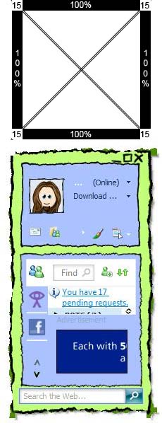

Having a discussion about this with willz, and it's because I have no straight lines I'm having REAL problems, all his shaped skins have some straight lines of some sort in them, and the corners are shape skinned.
I tried taking the 'tables' approach to solve the problem.
[Image: attachment.php?pid=913932]
But this has left me with problems shown in the bottom, the corner edges are all whack
I also tried cutting my mask into 4 quarters and having each at 50% width and height, that didn't work nice either. Neither did just a Left, Top, Right and Bottom all at 100% (respective width or height)
And 100% image mask, I can't add UMargins to so It stretches.
Currently using this top method is the best I got so far.
Also I've noticed that contact list restricted minimum size does not work, even though formatting is correct :S

This is what the current shaping code is
    <Region>
          <ContactList>
            <Rectangle Integration="add">
                <Left>0</Left>
                <Top>0</Top>
                <Width Unit="percent">100</Width>
                <Height Unit="percent">100</Height>
            </Rectangle>
            <Rectangle Integration="subtract">
                <Left>0</Left>
                <Top>0</Top>
                <Height>15</Height>
            </Rectangle>
                <Left>0</Left>
                <Top>0</Top>
                <Width>15</Width>
            </Rectangle>
                <Right>0</Right>
                <Bottom>0</Bottom>
                <Height>15</Height>
            </Rectangle>
                <Right>0</Right>
                <Bottom>0</Bottom>
                <Width>15</Width>
            </Rectangle>
            <Image Integration="add">
                <Source>
                    <File>images\Window Design\BL.png</File>
                </Source>
                <Position>
                    <Left>0</Left>
                    <Bottom>0</Bottom>
                    <Width>15</Width>
                    <Height>15</Height>
                </Position>
            </Image>
                <Source>
                    <File>images\Window Design\L.png</File>
                </Source>
                <Position>
                    <Left>0</Left>
                    <Bottom>15</Bottom>
                    <Top>15</Top>
                    <Width>15</Width>
                </Position>
            </Image>
                <Source>
                    <File>images\Window Design\TL.png</File>
                </Source>
                <Position>
                    <Left>0</Left>
                    <Top>0</Top>
                    <Width>15</Width>
                    <Height>15</Height>
                </Position>
            </Image>
                <Source>
                    <File>images\Window Design\T.png</File>
                </Source>
                <Position>
                    <Left>15</Left>
                    <Right>15</Right>
                    <Top>0</Top>
                    <Height>15</Height>
                </Position>
            </Image>
                <Source>
                    <File>images\Window Design\TR.png</File>
                </Source>
                <Position>
                    <Right>0</Right>
                    <Top>0</Top>
                    <Width>15</Width>
                    <Height>15</Height>
                </Position>
            </Image>
                <Source>
                    <File>images\Window Design\R.png</File>
                </Source>
                <Position>
                    <Right>0</Right>
                    <Bottom>15</Bottom>
                    <Top>15</Top>
                    <Width>15</Width>
                </Position>
            </Image>
                <Source>
                    <File>images\Window Design\BR.png</File>
                </Source>
                <Position>
                    <Right>0</Right>
                    <Bottom>0</Bottom>
                    <Width>15</Width>
                    <Height>15</Height>
                </Position>
            </Image>
                <Source>
                    <File>images\Window Design\B.png</File>
                </Source>
                <Position>
                    <Left>15</Left>
                    <Right>15</Right>
                    <Bottom>0</Bottom>
                    <Height>15</Height>
                </Position>
            </Image>
          </ContactList>

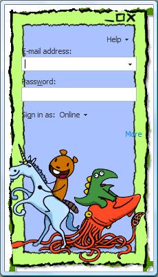

This image (due to some aero/messenger error) shows more clearly what pieces are missing....
[Image: attachment.php?pid=913936]
EDIT: I've fixed the top left corner now, had that at 50% width and height still, but the others remain unfixed.
I guess the main problem is that we can't "center" the mask pieces and I'm trying to tell it to align to both the left with a 15pxl padding and the right with a 15 pxl padding
and it only want to align/pad one side.
ALRIGHT!
Managed to do what I was after using Subtract instead of add.
UMargins, would still be REALLY nice though (a)
