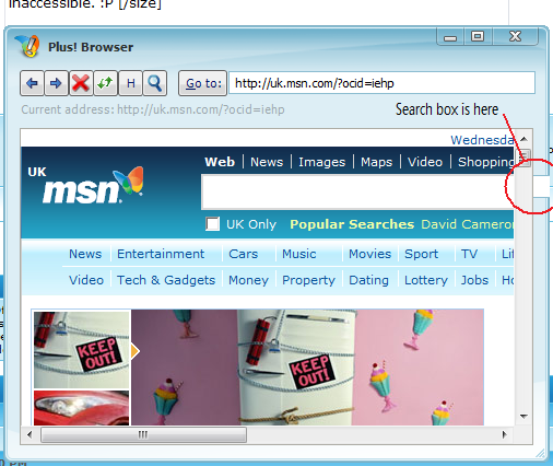

<Window Id="WndSearch" Version="1">
    <Position Width="400" Height="150"/>
    <ChildTmpl>
This is just after your commented out original search window. You don't close <ChildTmpl>. After changing this to <ChildTmpl/> the script works for me.
Just out of curiosity, are you sure you want a child window and not a modal one? A child window gets placed on the parent form, whereas a modal window is a seperate window that has to be closed before you can do anything further on the parent window. The way your code and xml currently works (as a child window) is that the search textbox & label get hidden behind the browser object and are thus inaccessible (see attached pic) :P
.png File Attachment: searchhidden.png (105.26 KB)
This file has been downloaded 100 time(s).
This post was edited on 02-25-2009 at 05:49 PM by pollolibredegrasa.

Umm...  in that case, I would probably want a modal window, but I have no idea how to do that.  :S
I thought a modal window was a child window...  I'm confused now.  :P

A child window is a seperate window like in the Plus! Preferences. The section that changes when you click a different tab... is a child window. A modal window is a seperate window. Instead why not make it like IE and FF and have the search box beside the address bar?
