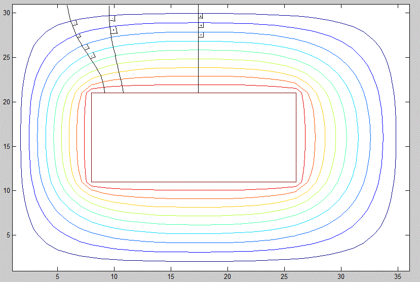

I have a matrix of electric potentials values, and used contour to draw equipotential lines. Just fine. Now, I need to draw the current lines, which are perpendicular to the equipotential lines.
[Image: attachment.php?pid=993326]
I draw these 3 lines using paint, that's why it sucks, but I think you can understand.
Using quiver was very close to what I need, but it plots arrows, instead of lines.

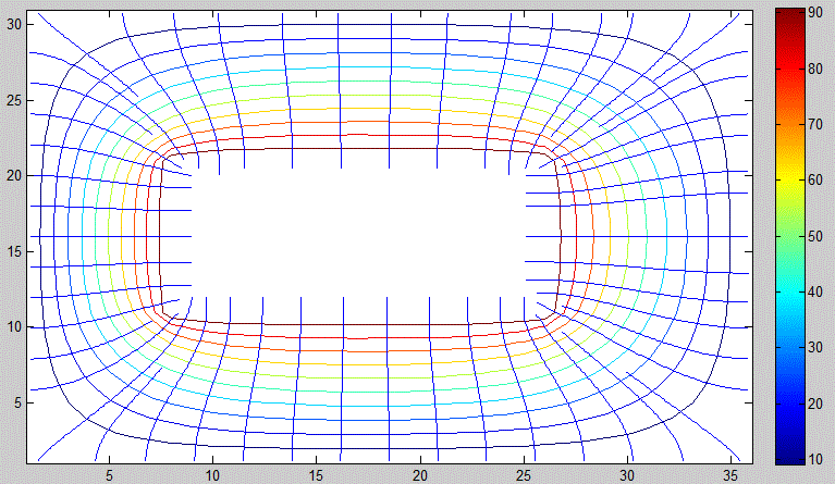

Nevermind.
I defined:
MATLAB code:
[DX, DY] = gradient(m) %m is the matrix.
streamslice(DX, DY);
