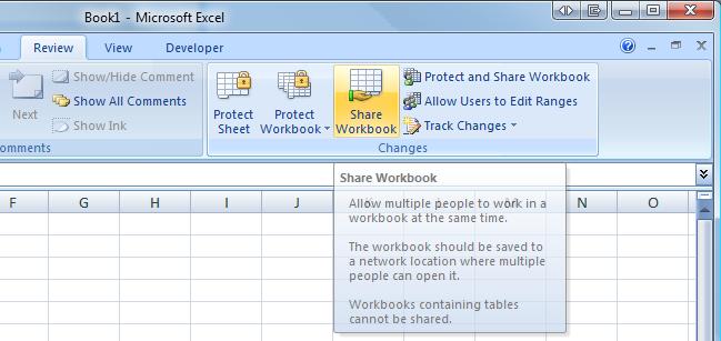

If it is a shared excel document it should allow for multiple people to edit the document simultaneously though. Are you sure you enabled the sharing properly or do you mean it is just shared on a network drive?
[Image: attachment.php?pid=994691]
.jpg File Attachment: excel_share_workbook.jpg (37.47 KB)
This file has been downloaded 1709 time(s).

Why not use the Share Workbook feature which will allow multiple people to edit the document silmultaneously? When 2 people are editing the document simultaneously here is what happens
Person A Opens the Document
Person A Makes some Changes
Person B Opens the Document
Person A Saves Changes
Person B makes somce Changes
Person B saves changes
Person B's changes will be merged with Person A's changes

Doing that limits the options of editing that workbook like adding charts and inserting images,creating new data tables. :)

Whenever user A opens the Excel file, he can edit it and save it as much as he likes. And indeed, user B will only be able to open it as read-only when the doc is already opened by person A.
(if you want person B to also edit the file at the same time you need to do what matty suggested - no need for Google Docs at all. In fact Google Docs can not do what isn't already possible in Excel nativly or Office Live itself)
