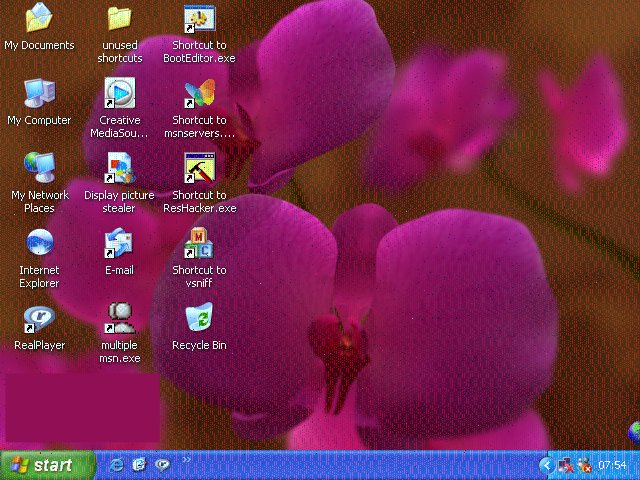

The first time I turn on my pc everyday the bootscreen looks dodgyand when windows has started it looks like the attatchemnt, 800x600 extremely flickery poor quality that only goes away when I reboot the computer. How do I get rid of this?

It looks like your graphic card connection is messed up (for all that flickering) or and internal failre (for ignoring the drivers and setting itself to 800x600).
Anyway, you should try to unplug and plug again the card and the cable. And probably change the graphic card. It could be as well your monitor. Test other cards/monitos top find where the error is. It might be the cable aswell, but it's unlikely. Be aware anyway ;).

Thanks, hope nothing has fried in there though. My graphics card has its own fan on and my pc gets no physical abuse. Could well be the monitor, but why only on reboot should it become normal again. I'll open it up later and have a look.

Swapped monitors with my old pc, and it still happens:( Seems to happen every otehr time I turn on my computer. Looked inside and everything seems fine, and fitted a DVD drive, and thats all ok, but the screen is still screwing up.

It doesn't go away, the screen resolution and poor quality stay, so then I reboot the computer and everything is fine again. Possible virus or not aswell? Personally after swapping monitors I'd guess it was my graphics card like KeyStorm said, but it looked ok when I looked at it.

The resolution issue is usually due to a corrupted driver or a bug in any app using it.
But that fuzziness... Makesme think of the worst. I'm certainly sure it's the graphics card.
Did you swap the VGA cable? (Marginal possibility, but still possible :P).

exactly. Try to reinstall the drivers of the graphics card. Also make sure that none of the programs running is set to run in compatibility mode with 256 colors or 640*480 etc...
Originally posted by tomfletcherman
800x600
it seems to me 640x480

increase the frequency
properties>settings>advanced
and put supported by your monitor and video card frequency rate
not sure tho but try

Anyway, I'm afraid the flickering is not cauuse neither by the driver nor by anyconfiguration. IMO, there is something broken in the graphics card. I'm afraid you'll have to buy a new one... :-/
