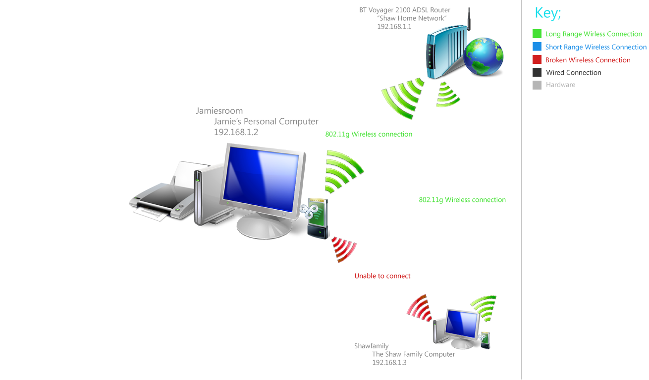

I have toiled for hours on end to get a Wireless File and Printer sharing network over 802.11g/b for the teo Computers in my household.
Yet, after all that, I have got nowhere. I have tried googling for websites for help and advice but yet nothing. I followed steps but still nothing. So, i thought some of you may be able to help (as I like advice with a real person rather than reading from a site).
Some background info if needed;
• Both computers are running Windows XP Home Edition Service Pack 2
• Both computers have BT Voyager 1040 PCI 802.11b/g Adapters installed
• Connecting to a BT Voyager 2100 ADSL Wireless Router/Modem
I have included a diagram showing some details and images of what I have so far.
If someone could give me steps on how to get the two computers connected or point me to a "Reliable" website that will help me in my problem, it would be greatly appreciated.

Networking is a pain, and I have exactly the same problem as you, my computers on the network wont communicate with each other. This is a problem for me because I can't access files on different computer hard drives. Before we got a wireless/network printer I couldn't share the printer either. If your printer has an ethernet socket you could plug it into the router. Something to take note of is that the comunication you have drawn that goes between your two computers would mean the were in ad-hoc mode, which they aren't, it is worth remembering that any communication between your computer and your family's goes through your router first.

I just used Network Magic and it's connected them a snap.
I didn't need to play around, it just connected them for me.
I think the reason the SOHO wizard in XP wasn't working is because Norton Personal Firewall (Installed on my PC) was blocking networking IP address or whatever...
Network Magic opens the wizard and configured it for me.
