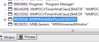

Are you sure the class name is "WMP9MediaBarFlyout1342137C" and not just "WMP9MediaBarFlyout"?  If the window exists and you've got the class name correct, it *should* be found.  How are you determining the class name?  Spy++?

I'm using Winspector:
[Image: attachment.php?pid=965779]

Try tracing out the parameters right before the call to FindWindowExW.  Make sure that they are being passed correctly. (not getting messed up by the "typeof var")
