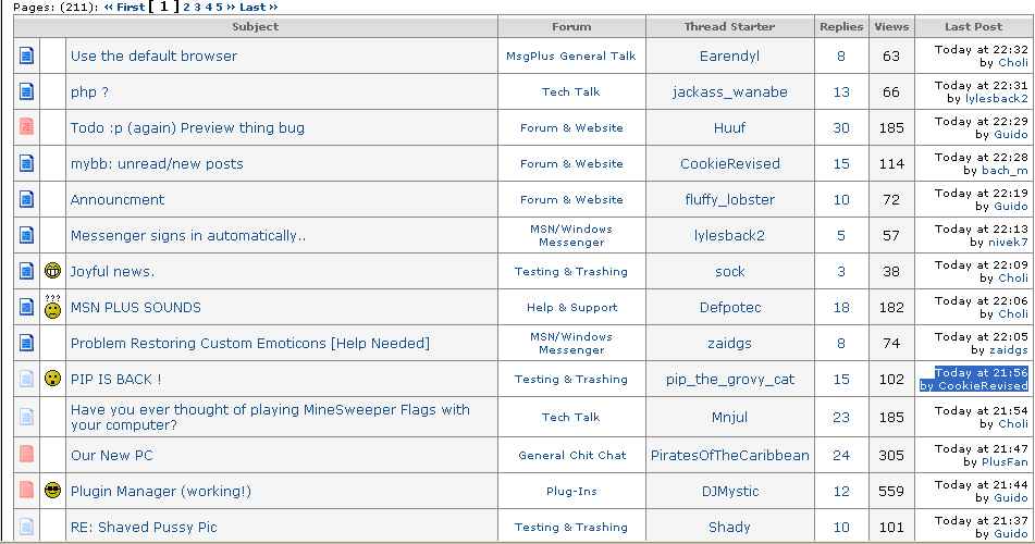

O.P. RE: mybb: unread/new posts
:@ :@ :@ , ok WDZ I'm complaing again....
the bug kicked in again....
I had 20 unread posts (could be more though), did a refresh... BAM.... only 9 unread posts anymore....
To give an example: before refresh the thread "Easter Eggs" was marked as unread (as it was a new thread). I did a refresh.... it is marked as read, while I never openend that thread....
It seems that this is what happend:
* +20 unread posts in "View Latest Posts"
* I open 1 thread ("PIP is back") and reply to it... (this thread was somewhere in the middle of all the other unread ones)
* I close the thread
* I do a refresh on the "View Latest Posts"
* Only 9 threads show up as unread....
* The cookie seems to be reset to the time/date I posted my last message. But this certainly doesn't mean I read the (unread) threads before this time/date......
(this also means you can't use that time/date as a reference to look for threads you haven't read. This means I have to open +20 threads to see by myself if there is a new message)
.jpg File Attachment: unread.jpg (70.36 KB)
This file has been downloaded 187 time(s).
This post was edited on 01-10-2004 at 09:48 PM by CookieRevised.
