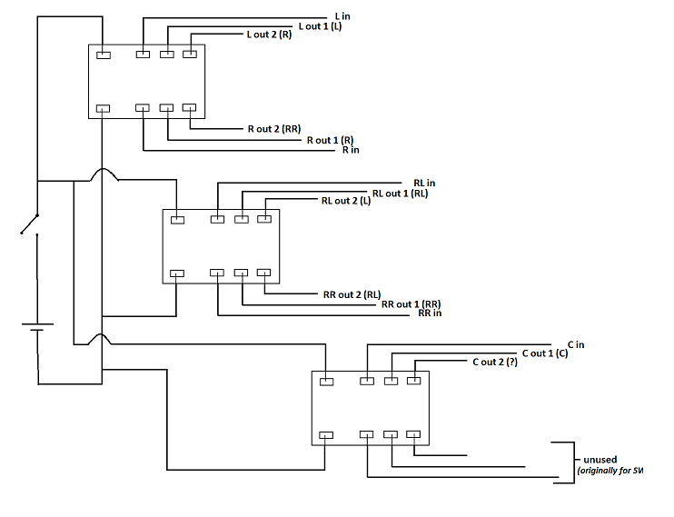

NB: Example of multiple relays wiring:
[Image: attachment.php?pid=983626]
(Sorry about the slightly wierd overlapping wiring on the relay side, it's basically three relays in parallel but showing them side by side too too much room...)
This will act in the same way as a single 6PDT in place of the 3 DPDT, but in my experience this way would be cheaper and less confusing only switching the 2 channels per relay. If it turns out you end up not switching central and SW then you can obviously remove the bottom relay (or just use a single 4PDT).

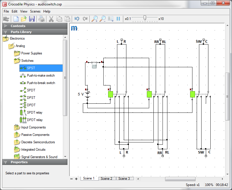

So let me get this straight... If I take the relay route (which looks like is what I'll be taking), I'll have to build the following circuit, right (sorry for the crappy diagram)?
[Image: attachment.php?pid=983628]
Also, I should be able to use power from a USB port, right?

EDIT: Thanks stoshrocket, that diagram looks a lot better than mine :P
.png File Attachment: audioswitch.png (77.84 KB)
You can easily draw 500mA at 5V from a Usb port. If you wanted to get really fancy you could throw some transistors and a flip flop and have it USB controlled, but I'd stick to just getting it working. ;) All kidding aside, Getting power should be no problem though, just make sure your relays aren't too power hungry. Interfacing with USB is much harder and probably way overkill for your application.
I'm pretty sure that diagram is correct if your inputs are on the bottom. Not sure if it'd work in both directions. I'm assuming that when you're in your PC position the plan is to simply turn off the centre channel. Also: save yourself some connections and don't bother running the sub through the relay.
