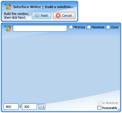

That's what I've thought about doing.  The user can always change it to dialog units if they want, but if they use the builder, then it'll have to be in pixels.  :P
[Image: attachment.php?pid=983973]
That's what the builder will look like.  ;)  Suggestions welcome.
Edit: I really doubt the feasibility of this, but I'm going to ask anyway.  Is there a way of working out the co-ordinates of a rectangle drawn with the mouse onto a Plus! window?  Would this need a certain control?  If this isn't possible, would I be able to record two clicks (one for the top-left, one for the bottom-right)?
It certainly should be possible. You would have to deal with drawing the rectangle yourself using GDI or whatever, but you would basically just have to handle mouse messages (WM_LBUTTONDOWN,WM_MOUSEMOVE,etc.) and redraw the rectangle each time. Unfortunately there's no magic control that does this for you that I know of, but it shouldn't be too hard to implement.

I've had a look at the two files, but I'm not exactly sure how to implement it.  How would I be able to draw a rectangle over a Plus! window, and get the left/top/width/height values in relation to that window?
