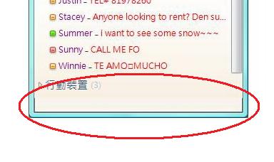

Sorry, I meant to say NOW it works. I think I installed something that was interfering w/ the skin, so I had to reinstall it. Thanks again. Any idea on how to solve the spacing at the bottom of the window? I attached a picture to show what I'm talking about.

RE: [Released]Skin wich only provides Options
def 923
XML code:
<Element layoutpos=bottom layout=BorderLayout() id=atom(TabsAndAds)>
<element background=rcbkd("msgr",627) height=0 layoutpos=none/>
layoutpos=bottomlayoutpos=none
XML code:
<Element layoutpos=none layout=BorderLayout() id=atom(TabsAndAds)>
edit: thus :P

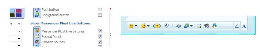

Also, I don't know if this is a bug or not, but when I check the box for "Messenger Plus! Live Settings" under the conversation window option, it doesn't show up in the actual conv. window. But the format panel, scripts, etc. works fine. I attached a screenshot. Thanks.
That may well be a bug with the skin.....have to wait to see if anyone else can confirm.
Can anyone else confirm this bug? Or is it just me? Thanks.
yes. Also I got it. would have to wait for an update.
Meanwhile press Alt :P
