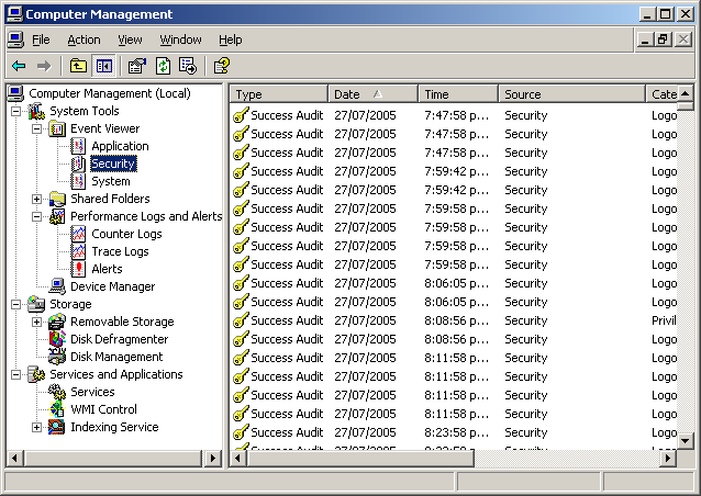

Take a look at this:
[Image: attachment.php?pid=504724]
Control Panel -> Administrative Tools -> Computer Management
I don't understand when most of this means but at least you have a pretty good idea of when the computer has been active.

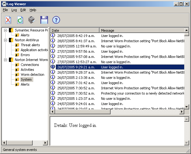

Also, if you've got an anti-virus program I think that will definitely have logs too. This is probably more accurate as it logs when it starts and stops, which surprisingly also happens to be when you log in and out..
[Image: attachment.php?pid=504728]

RE: Logging XP User Log On Times
I'd use the Event Viewer like multimillion2k said. You can quickly access that by doing Start > Run > eventvwr.msc then going to the Security section.
When a user logs on, a "Logon/Logoff" event (number 528) will be generated, and it will show the associated username as well as the exact time. The same goes for logging off, except the event number is 551.
