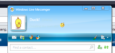

well, im in the middle of making a skin, and with the current head and dashboard i have the name, status and personal message have become unreadable =/
(See attachment)
Ive looked around the scripting documention but couldn't seem to find an answer
Also if i was to allow users to change the contact list color in the edit options area, how would i go about doing this?
Thanks

Font colors are defined in UIFILEs. I suggest you to look up the element of the nickname/status/PSM in UIFILE 923 and then check out the style UIFILE for 923. You should be able to find the style definition for the element there, and there you can add/change the color attribute. ;)

Basically do what he has said. You name will be in UIfile 923 under "idFriendlyName". Change "foreground:" to "rcclr(20014);" That should give you a black name. I'm assuming you know how to do the rest already.

Duck, take a look at my skin in the 923 style, you;ll see how I edited mine :)

well..ive done that but its still not changing the color, i have no idea why..
i only had to put the idfriendlyname bit in...didn't i? :P
in 923 style.txt i have:
emoticontext[id=atom(idFriendlyName)]
    contentalign:endellipsis;
    fontsize:9pt;
    fontface:"Arial";
    fontweight:600;
    padding:rect(0,0,0,0);
    foreground:rgb(0,0,0);
thanks, im a nub when its comes to skinning :-$
in skininfo.xml i have
    <Resources>
                    <Replace>
                   <Styles>
                     <Style Id="923"><File>Dev\923 style.txt</File></Style>
                   </Styles>
                   </Replace>
    </Resources>

I thought you had to have the whole contents of the original style id in the txt document as you are replacing the style id

Originally posted by freak544
I thought you had to have the whole contents of the original style id in the txt document as you are replacing the style is
I could be wrong though as I am new to skinning but have coded before
correct

isn't 1001 the contact list rather than 923?
this thread reminded me of an addition i could make to mine.......i went and changed every fontface reference in 923 and the contact list text didn't change, just the text in the surrounding frame........923 is the contact list window, but 1001 is the contact list itself i think
which may explain why it doesn't work
i think he was just showing the bits of code relevant to this particular change, rather than posting the whole 1300 lines of his 923 style.txt ;)

Basically i need to just change to color of the personal message :
Edit: Ive now got the name done, thats black, turns out i was putting the id as "932" instead of "923"
